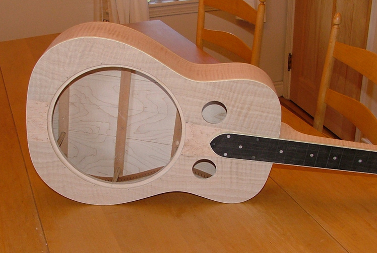

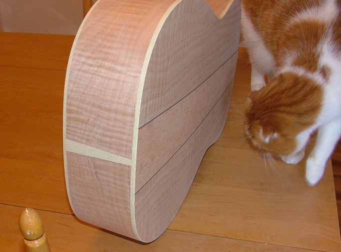

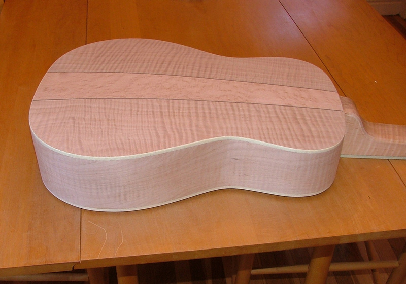

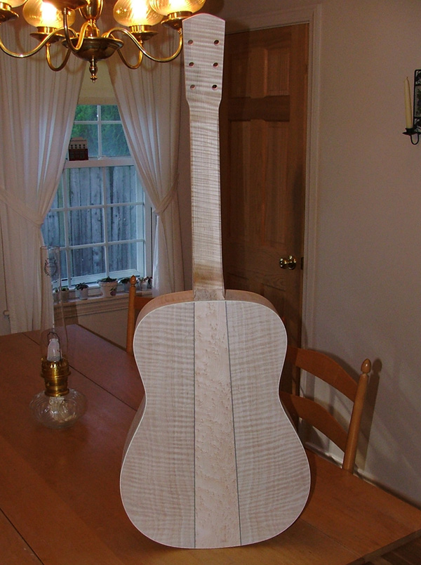

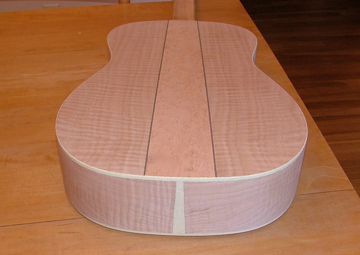

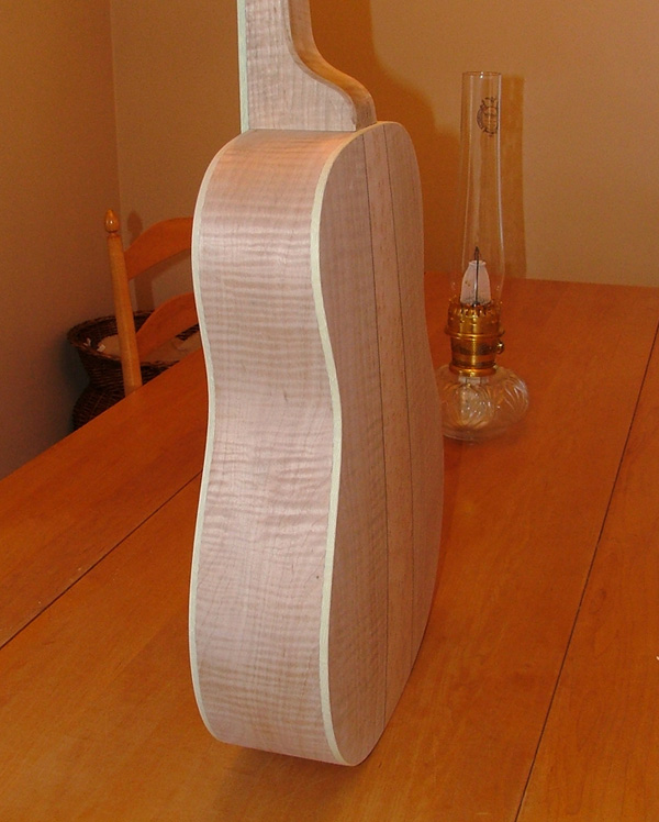

I'm finally to the "in the white" stage of my resonator, and would like advice on what color you think would look good on this thing. I'm tempted to do a vintage maple burst, which is a sort-of medium golden brown, to an amber in the center, transparent enough to not hide any of the flame in the maple. I've also thought about just staining it a medium vintage maple. I've also thought about other colored bursts, but would like your opinions as to wht you think would look good. Please think about how the birdseye center wedge will look in either case.
Thanks!
Had to sneak that last one in...he's my QA inspector.

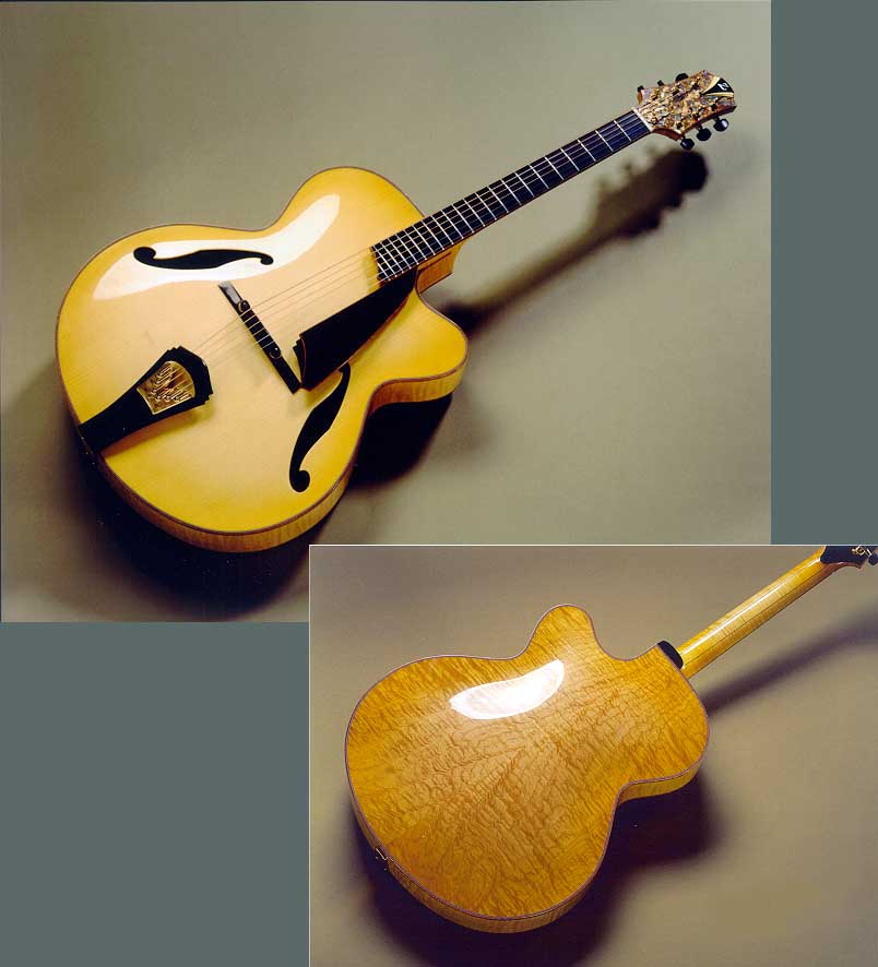

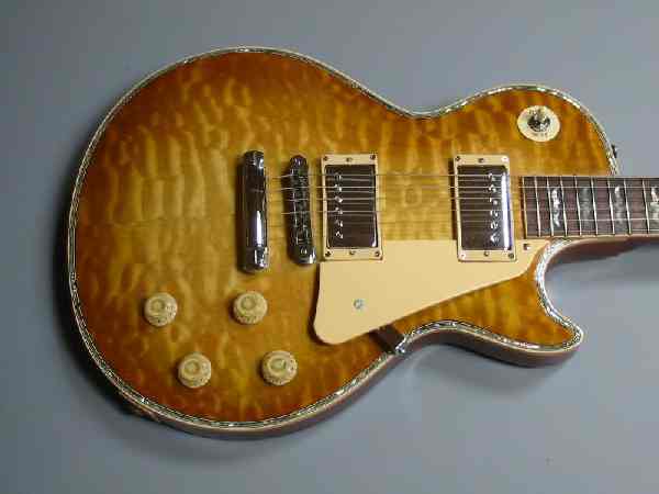

PostPosted: Sun Sep 25, 2005 4:52 am
This is probably a tad darker than what I am thinking... but it should give you an idea of what I am thinking.
(Not one of my gutiars... nice though)

PostPosted: Sun Sep 25, 2005 5:36 am
OOoooooo....brock that's exactly what I was thinking about....it's gorgeous! Is that a Gibson, or someone's version of Les Paul?

Hey Don,
IMHO, because you put so much work into the 3-piece plates, you don't
want to hide what's going on visually. Maybe just a subtle burst, even
lighter at the edges than the Gibson (?) electric. A very light reddish
brown into the amber? Looking at the pics, I think it's a shame to hide any
of the impeccable workmanship. Go slow because the color always comes
up stronger after you hit it with finish. Are you thinking of covering the
binding with the burst as well? Again, IMHO, it would look best if you did.

PostPosted: Sun Sep 25, 2005 11:49 pm
I'm leaning toward just spraying with the honey amber tint in the finish. I'm planning on leaving the bindings natural. I threw a coat of shellac on the thing last night, and it looks so good I'm tempted to not stain at all. I never thought I'd ever want to own a maple guitar, but now I think I need a round-neck resonator to accompany this one. I'll probably do the same 3-piece construction on that one too.

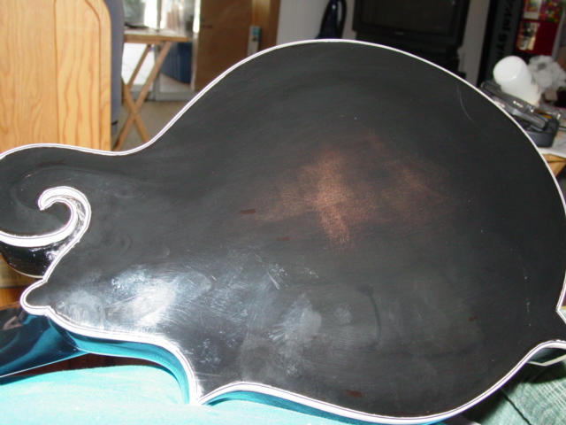

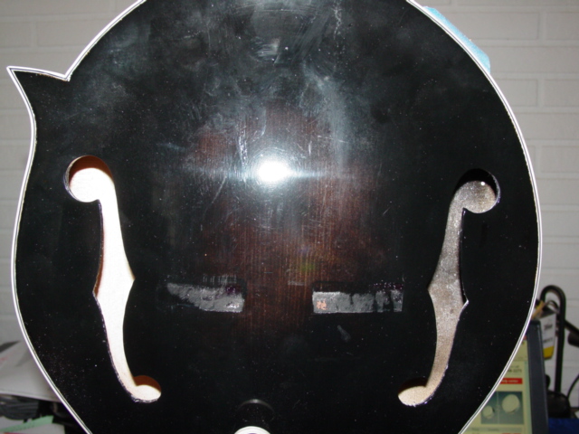

Don,
I don't know if you remember this mando...it was a realy beatup one sprayed black (looked like from a can) and needed new everything. I put this burst on it which in person is much lighter than the camera makes it look. I tinted the clear with amber to "age" the binding etc.
BEFORE:
After:
If the box had the flame like yours I think I would have left it with just amberDave-SKG38623.4230671296

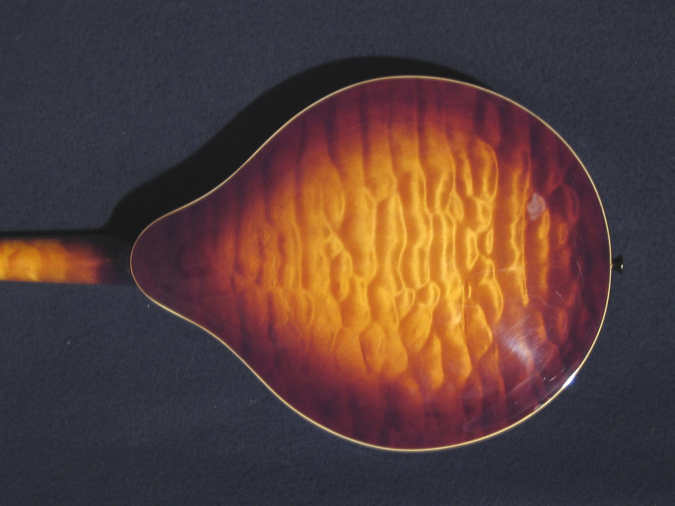

I did this one, I like a burst that still shows how nice the wood is.
PostPosted: Mon Sep 26, 2005 5:18 am
Just beautiful Adam...
...do you mind me asking what you used for that amberish yellow?
Is that the Zeidler Project guitar?
PostPosted: Mon Sep 26, 2005 7:13 am
I love the trasparancy of this Don
PostPosted: Mon Sep 26, 2005 7:57 am
Me too.....
